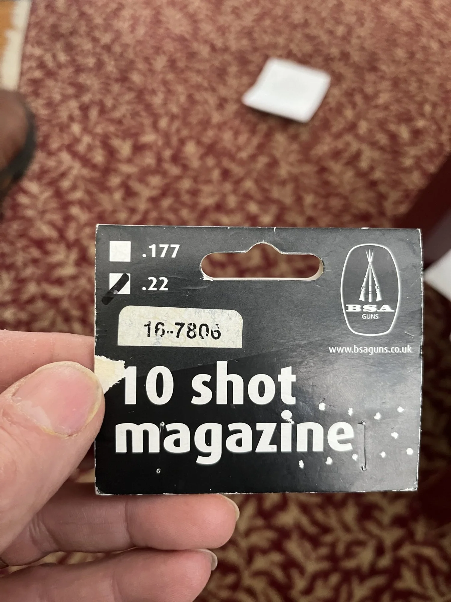

FWIW These work fine in a Super 10
They’re not usually specked for use in an S10
But the notch cut out is specifically for them.
Dealers don’t even seem to know that
View attachment 898912View attachment 898911
The other mag that came with the Super 10 is on of those. Works fine.
I just tried a modern (not clx, one before) and that seems to fit, but need to look closer as it requires precise placement in slot doesn't just pop in.
The coloured plastic rotor bsa mags foul on the indexing pin for the tick tock mags,assuming that's still present. Easy to remove
Many thanks, yes easy to remove I've done one before on a Ultra MMC, but someone's already been inside this one and removed it.
It feels like there's a burr or something not helping it sit right. I'll investigate sometime as the other mags I have work fine atm.
