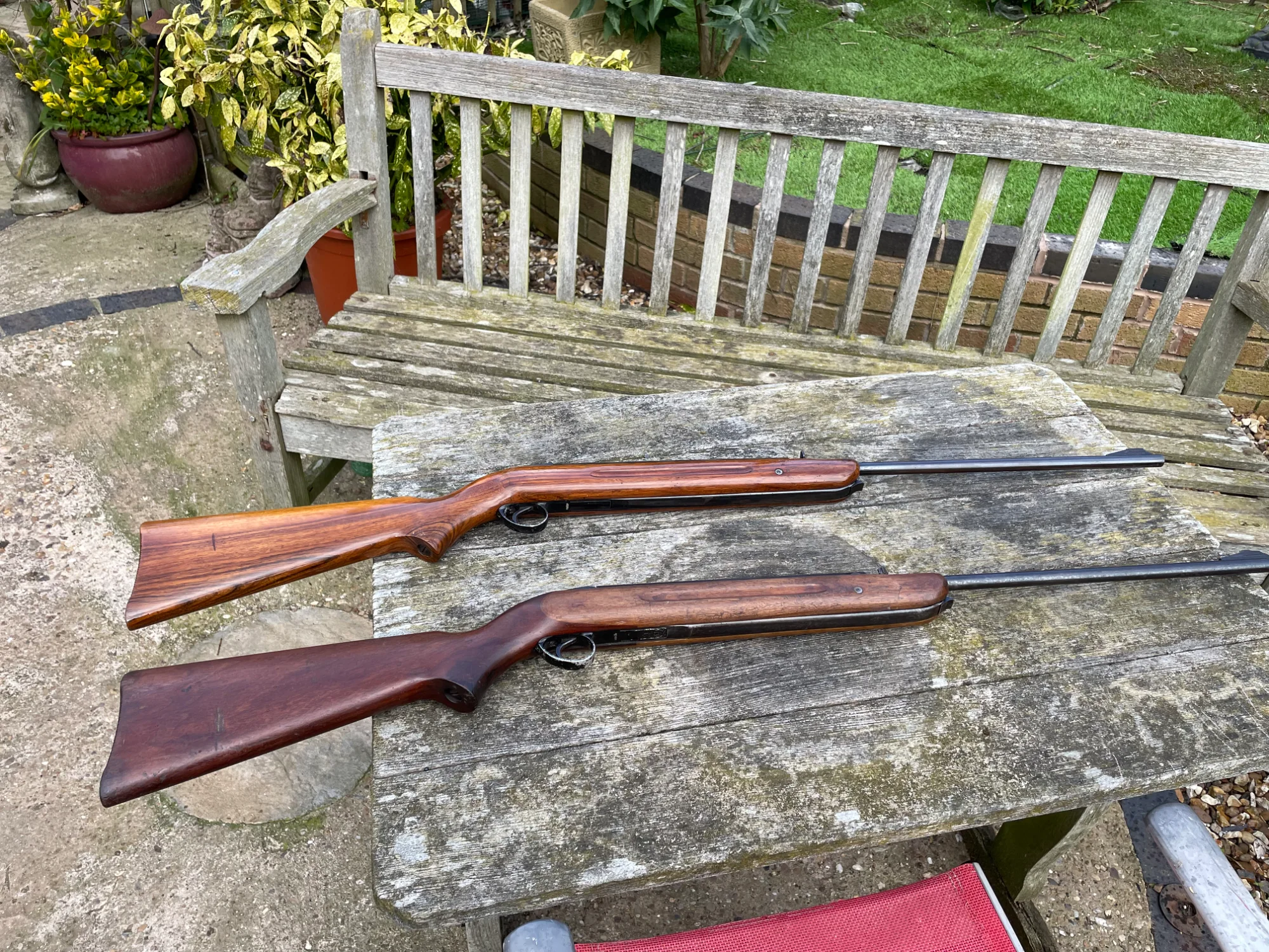

A couple of pictures of an interesting pair
The bottom one was acquired yesterday and the woodwork is an interesting combination of colours, needs a good strip and refinish.
More interestingly the top one has the 2 pairs of scope rail, whilst the bottom one has regular rails. When did BSA make the change?
The serial number should tell you what it is, although BSA don't always follow a standard in terms of features, etc...you may have a Mk 2.5 !
Lovely old guns, the Mk2 is what started it all for me in the sport almost 50 years ago. My Grandad's Airsporter....it's still going, he sadly isn't any more :(
Have looked up the serial numbers. The top one in the pic with the pair of scope rails is GD so 59-65, the bottom one is GE so 65-67 with the full scope rail, so possibly the change was made around 65?
