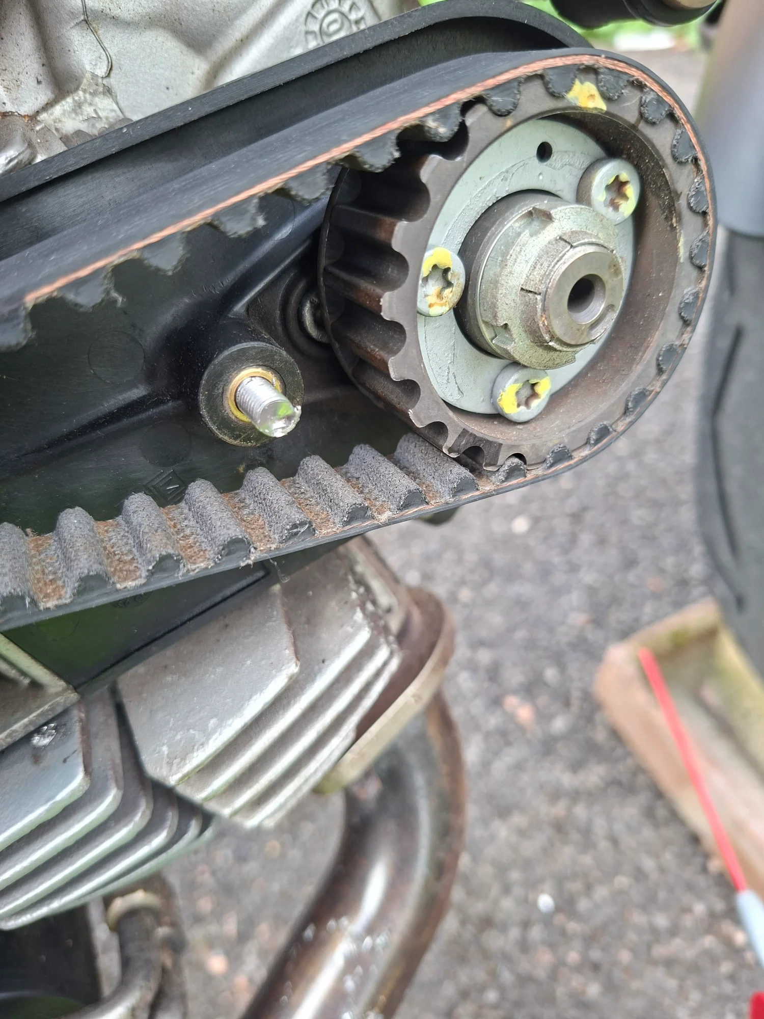

View attachment 961024View attachment 961025

The stub of the bolt came out easy enough, probably the Heat and the vibration broke it free.
Had a soldering iron in the brass insert for about 15 minutes, the bloody thing is still spinning.
Could you pin it below the bolt depth?
Yeah, I'll figure something out, that's a job for another day. I'm thinking I might drill a small hole down the side of the insert at the top, squirt in some thin Super Glue and hopefully it will trickle around.
At least I got the cover off. 👍
Why not drill an 1/8 ( 3.2 mm) hole through the housing & into the insert , then a dab of JB Weld on a length of 1/8" high tensile wire & make a permanent locking bar for the insert ?
" Super glue" has zero/ zilch/ nada shear strength.
@chouchin66 Yes, I would have crossed drilled it and pinned it, but I have no access with the timing belt in place, and at the moment I don't want to take the timing belt off.
Plenty of meat around the insert, I could drill bigger holes down the side of the insert and use JB weld 👍
Heat plastic around insert with heat gun (not a flame) until it softens. Then using 2 locking pliers (mole grip type) clamp at 2 positions 90 degrees to each other to form a square.
If plastic is hot enough it will squeeze the insert tight again, just cool with cold water before removing pliers.
If not a cast/ pot metal housing, could you " stake" it with a flat punch, like you'd secure a front sight in it's transverse dovetail ?
Sorry late Ive done a few of these covers and air box coves that have the same problem .
first thing i always try is remove all the other bolts then cut down allen key iand put it in a drill . then i spin the bolt which spins the insert . this creats friction and heat which melts the plastic around it . then i let it cool and the insert normal resets .
this can also be use to remove the insert by spinning it and pulling the cover . cover off grad the insert with grips and undo the bolt .
