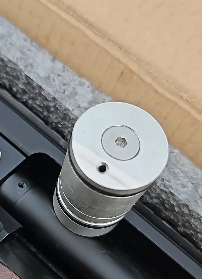

Guy this is going to sound like a stupid question, can you get preset regs for UK limit, only reason I ask is attached is the reg used, just wondering if it’s the right one.
Thanks
ThanksView attachment 499336
ahem, that looks like a FX Amp regulator. (ive 3 of them in the spares box)
reg presure has nothing to do with uk power limits.
you can get 12ftlbs from a reg set at 170 or 50 bar
