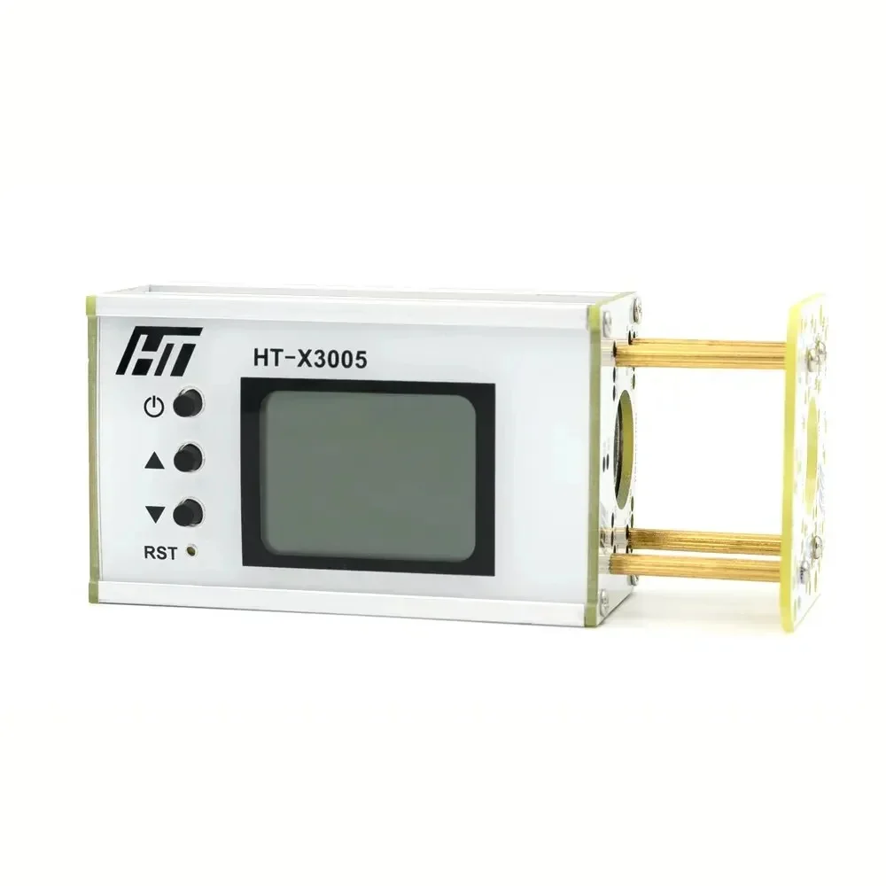

I just found this on AliExpress:
£26.10 | Speed Measuring Instrument for Shooting Speed Meter Ball Velocity Energy Measurement Shooting Chronograph Bullet Speed Tester
