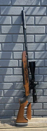

The hw30 is just perfect at what it does. Shot mine for an hour tonight and came home with a big grin on my face like a giddy school boy. They have very little recoil and are incredibly accurate due to this. Is there anything comparable full powered or around the 10a that’s made to run like that and has the same characteristics and very little felt recoil etc? Something made to run at that power and not detuned for the uk market etc.
