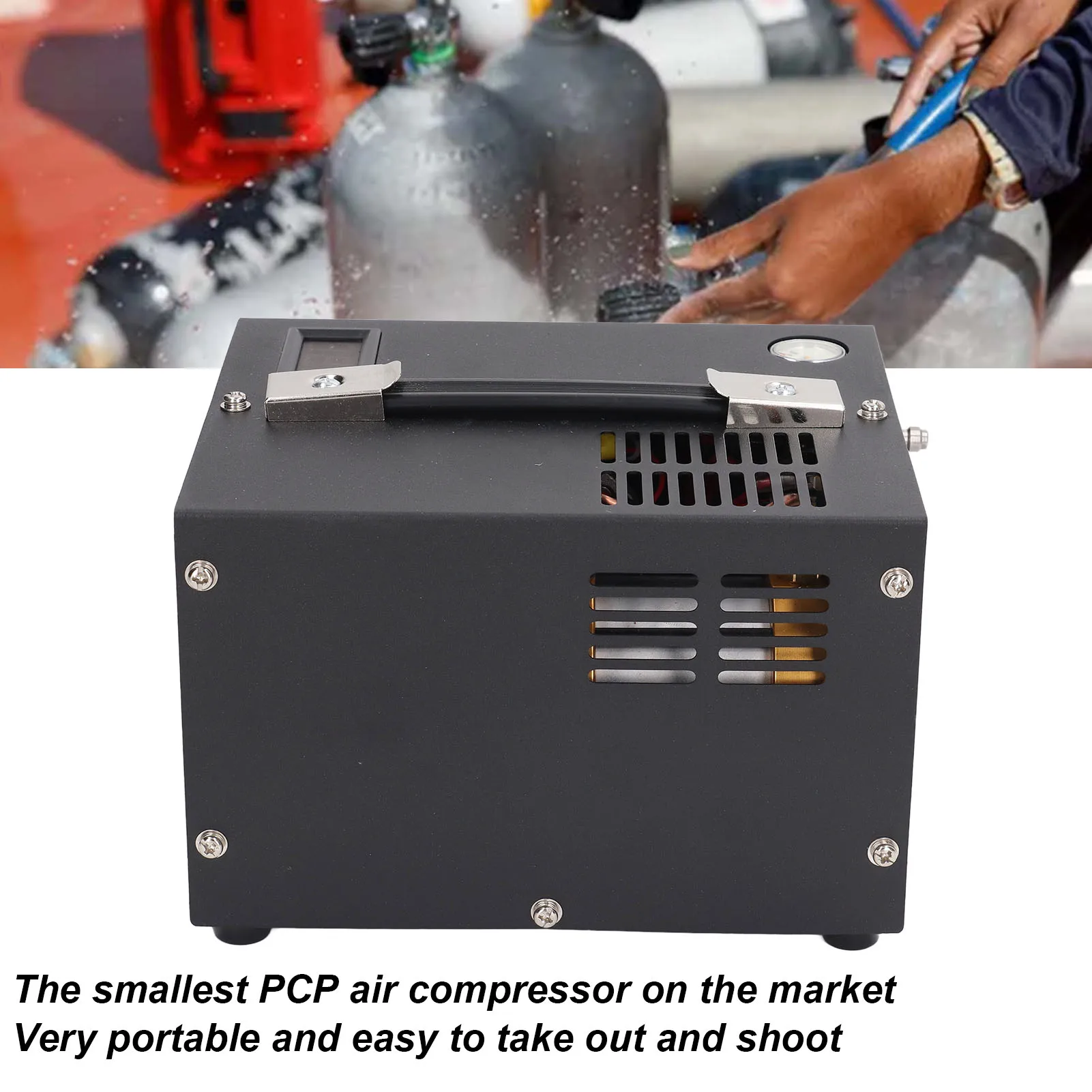

Has anyone used one of these? it says no water or oil needed. Just air cooling.
Would that be good enough to fill a small 100cc PCP rifle?
Would it possible to connect it to the mains instead of a car battery?
Thanks
To connect to the mains you would need a 12v supply capable of delivering the necessary 25amps. That's going to cost another £25-30. So that pump and supply will be around £115 with effectively no warrantee.
You might be better off looking at a tuxing from amazon (that comes with a power supply) and adding their 3 year warrantee - around £150 all in or £125 with one year's warantee. I would get one with a port to put a few drops of silicon oil in every 1.5 hours.

The Vevor compressor with integrated transformer failed a Trading Standards check due to a spade connector on the internal earth (a connection formerly used in many UK appliances but no longer compliant with electrical safety regs.) which was very simple to fix. If buying Tuxing clones from Aliexpress it might be sensible to do an electrical safety check and/or use only if RCD protected.

The earthing will normally pass testing. The reason for failing the UK safety standards is the spade connector could become detached, especially as the compressor vibrates, which could result in the case becoming unearthed. This is easily fixed by soldering or putting a screw through the connector. It's located at the back of the "kettle lead" socket.
If the case ever became live you would be protected by the RCD in your consumer unit. I'm guessing there are still old domestic installations in UK which aren't RCD protected. You most likely wouldn't be if running the compressor off a cheap generator.
