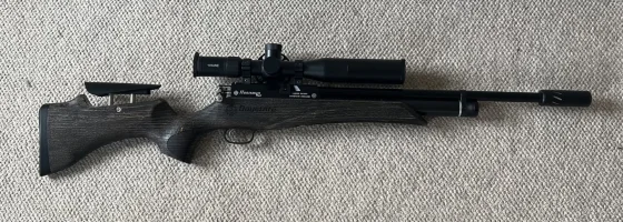

Although I went for the Safari stock as an add on to my bolt action Huntsman.
