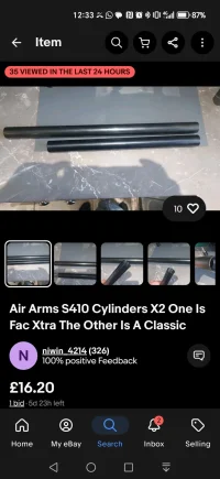

could be what you need 👍

Would your gun be the carbine action (300 mm cylinder) and the one you saw at the range be the longer classic version (400 mm cylinder)?
If yours is a carbine, just screwing on a classic length cylinder will give greater air capacity, but it will throw up a couple of other issues that will then need dealing with.
