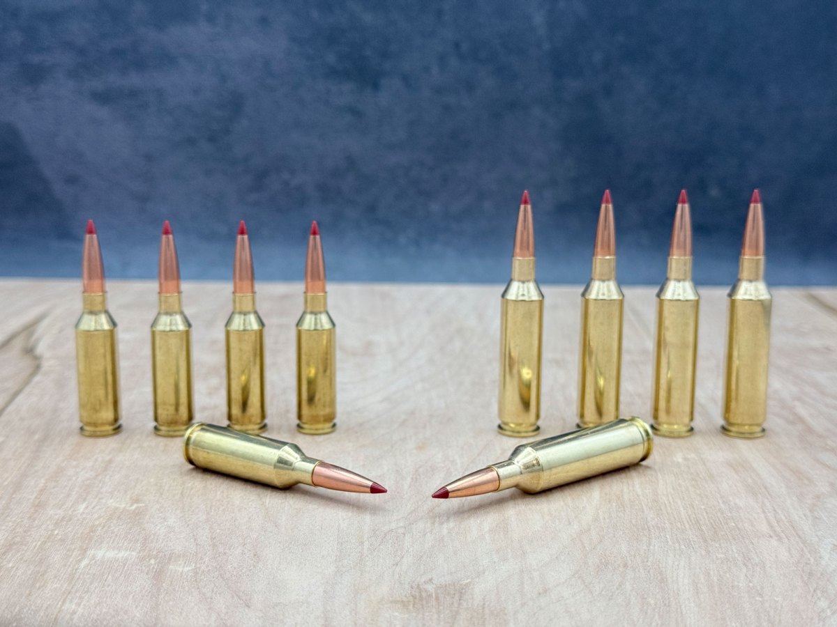

I'm mulling over switching my .222 over to .22 ARC. Been running some numbers through ApexLoad Pro and would like to do similar with GRT - but cant find a calibre on Discourse to upload to my version of GRT.
Will be for fox and small deer - looking at 60 gr Vmax and 70 grain CX. in a 20 inch barrel. Will need to get the bolt head opened up I suspect - but nothing to taxing for a good gun plumber..
Interested in any experience with this calibre - if any - or if anyone knows of a link to a file to upload the calibre to GRT.

Case volumes are near identical and a quick search revealed the 22 ARCs freebore to be SAAMI standardised at 0.130" .
If I remember correctly , Hornady merely changed the headspace to avoid legal problems on the 6ARC . Robert Whitley was credited with the 6 mm AR/Grendel to which the 6 ARC is near identical . Both being based on the 6.5 Grendel case , Whitley was a lawyer.
The bolt face will need opening up 👍
P.S . Never used one , be an interesting build .

Plus less powder, similar speeds from shorter barrel......better twist at 1:7 so can handle heavier and more ballistcally efficient projectiles...80-88 grains are achievable....but without the barrel-burner reputation that the 22-250 has.
Found the ARC file on Discord. I'll load it up and have a play.

So (especially for DOCTRAMP if he's reading this and probably spluttering into his copy of the Times/Telegraph or other broadsheet ;))....had a bit of a play with GRT and the relevant files.
Looks promising
30.5 grains 20 inch barrel and a 69 grain projectile doing 3100 plus......has potential.....

If I were to choose again , I'd still choose the 22 Creedmoor . Mine was built specifically to shoot 80 grain ELD-Ms and I'm bang on my velocity target . I could have easily exceeded that and did so using RS62, the ES were terrible .
The N165 is more temperature sensitive than I realised and became apparent very quickly .
If , instead of being a varminter of sorts , I was into paper punching , I'd favour the ARC . It would just make more sense . A long shot string isn't going to heat the barrel like the Creed and a longer barrel would close the gap on the velocity front .Though the 22 GT or XC would be worth considering, if funds allowed .
Hornady are brilliant at marketing, comparing the ARC to the 22-250 with incredible bias , had they shot the same bullet from a fast twist 22-250 and the ARC would have been dead in the water . It would have missed the point though as the ARC was originally targeted at the AR15 shooters .
I can't dis' the ARC , it makes a lot of sense . Time will tell about barrel life of the Creedmoor.

Thanks @Fox Tales , an interesting take. I agree about Hornady - a company that are experts in marketing - the 6.5 creed and 17HMR testify to that - and I'll be honest, a lot of their newer calibres don't really make sense to me.......but the ARC does ring some bells and definitely heart over head at the moment.
My thoughts are predominantly for field over target; and as a small deer in England and Roe in Dumfriesshire rifle with copper.
Barnes or Hornady CX around 3000 for that use would be ideal and looks like the ARC will do it - maybe even in a compact form .....which I do prefer....and may work in 18 inch format.
I actually shoot very few foxes each year so is the secondary choice really for this calibre.
It may get an occasional work out for Natural England on another substantially sized quarry too.......and I know that something capable of around 2900-3000 will work in Vmax style projectiles out to 150 on such quarry.
I suspect many of the newer modern projectile designs in . 224 are capable of that.

Interestingly SAMMI have only listed it with a max psi of 52000 - which is what the AR15 versions can handle. Hornady acknowledges 62000 as the maximum for bolt versions......so all commercial ammunition is sold with that in mind. As per the video, easily handles the pressure.
If (when) I go ahead, I will be working on the higher figure. Wonder what the proof rounds will be based on......suspect the lower figure.
