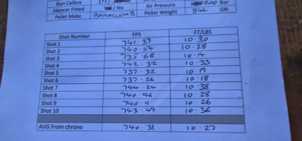

I've not had it long, but i must say i'm very disapointed with it. I have only tried barracuda 8's in it at the moment, and grouping at 30yrds is more like a £5 coin instead of a 5p coin.
I hope a different pellet will sort it, but i'm not holding my breath as i hear the cz barrels are very good and not that fussy.
Anybody else had problems with there's?
Mine uses 9.57 h and n and 9.56 qys seems very accurate with these. Not tried anything else yet though 👍
Had a discussion recently with a RFD, where he mentioned issues similar to your own. Apparently there have been some barrel crowning issues, which only seem to manifest on the Vulcan.
i'll have a look and see if i can see anything.
I bought it local to me, but it is an Edgar Brothers one
Yeh they are the ones to have. I met the head gunsmith from Edgar brothers jus before I got mine. Decent guy, I am sure they will sort it for you if need be. Just a ball ache having to send it back. 👍
Did you have it from new? Have you pulled the barrel through until clean? 👍🤓
Hey bud how's it going HNY, I think you need to be doing alot more pellet testing, try some JSB's. 10.34+8.44+7.87gr. I'll keep my fingers crossed for you, 🍻
I would try just a few more pellets and if no better, then certainly take it back. They are not cheap and should be right.
