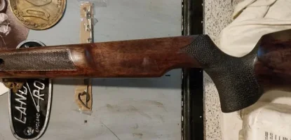

As the chequering on the grip had been ruined I removed it all using a Dremel type tool with a sanding attachment, once smooth I decided to stipple the whole area as on some target rifles, this both helps to disguise the cracks and also provides better grip.
Stippling simply means covering the area in question with dimple marks similar to on a golf ball, I used the same tool fitted with the bit below, I'm not sure what it is called but it does an acceptable job of stippling. I found holding the tool between 30-45 degrees gave the best results.
I stained the area to be worked on with a cheap furniture repair marker to make it easier to see progress, I also applied the same marker over the stippling to spot any missed areas. The beauty of stippling is that it is reasonably quick, the side shown below took about half an hour, and doesn't depend on super neatness to be effective.IMG20221221165934.webp

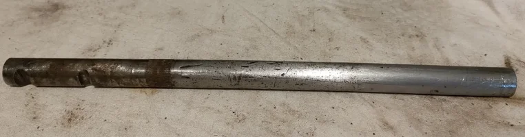

Well it's been a while but with many thanks to @deleted member progress has been made
Before:
After:
The barrel is not only straight but also recrowned and screwcut for a moderator.

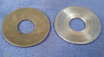

Hal also made a dished breech washer to replace the missing one.
