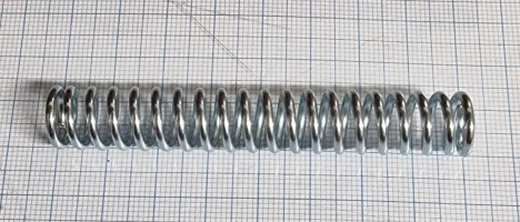

Existing spring is too strong I have deduced.
L 50mm x outer diameter 8.7mm (6mm inner diameter) x 1.25mm.
Want to keep the original spring but get some alternatives to play around with.
Any ideas what is available with similar dimensions.
Longer ones not a bother as I can can cut and play as I go along.
Thinking of maybe a shorter one of same dimensions or a 50mm one of thinner diameter wire?

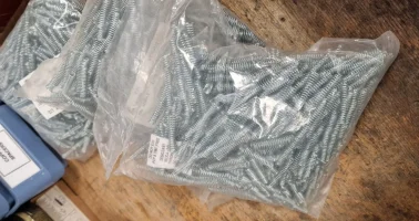

Wow.😲
Problem is if I bought that amount of something, I would put it in a special place, not find it when I needed it, then buy it again πŸ˜‚πŸ˜‚πŸ˜‚
Talking of which.
I may have found what I have been looking for in one of the bits tubs πŸ˜‚.
And like I said I just went and ordered some other ones πŸ˜‚πŸ˜‚πŸ˜‚.
At least they are not expensive!
