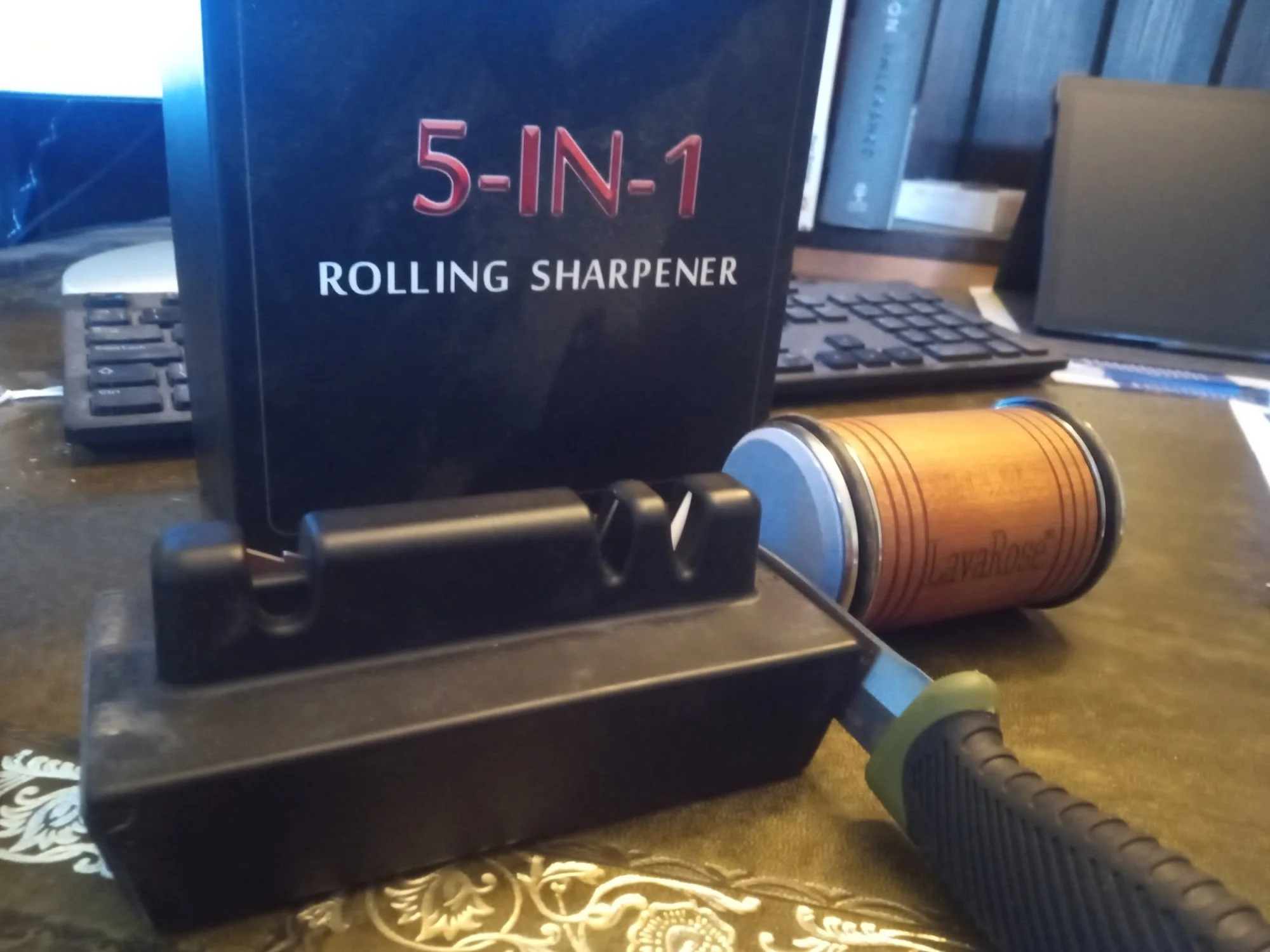

I've been using this for my kitchen knives for years, leaves the razor sharp and is idiot proof.
The block is magnetic and holds the blade at an angle 20 degrees one side 15 the other and the barrel is rolled along the blade, each side of the barrel has a different grade of abrasive.
