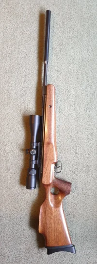

What have your experiences been with shorter barrels on springers? I'm talking about 20cm barrels for example? I know FX PCPs and other brands have short barrels on some of their models. Obviously, the quality of the barrel is key, but I do wonder if there is a downside to short barrels on springers.
My HW80, pictured elsewhere on this forum, has 14" of barrel including the silencer. It takes some effort to cock it, to the point where someone of slighter build than me might not be able to do it. All things being equal, this would not be a problem on an underlever rifle like a ProSport or an Airsporter. Less barrel might mean less accuracy, but also more velocity. An experiment to find the "sweet spot" would not be hard to set up, but would result in the destruction of at least one barrel, and possibly the rifle to which it was attached. Iirc, the Theoben Fenman had not very much barrel at all, but that had a much smoother cocking stroke than any springer I ever shot.
