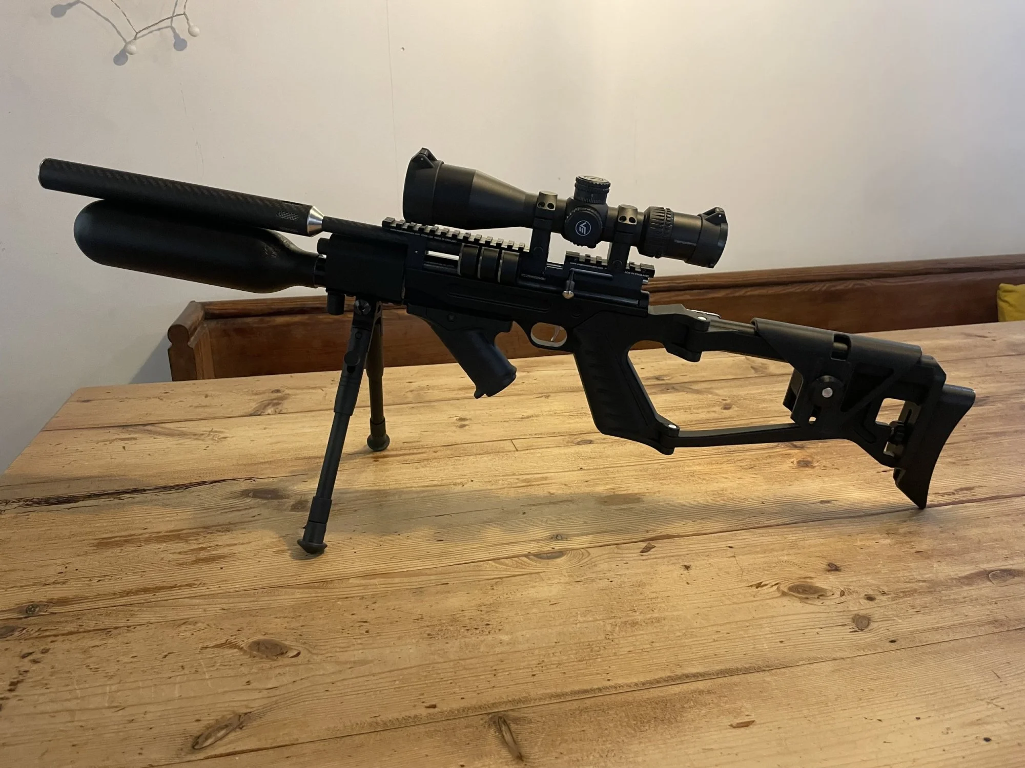

Picked up this awesome CP1 from the brilliant @BigBadBubbage threw on a little scope and a bipod. A brilliant little plinker and awesome for my kid to learn to shoot on. Absolutely love it.

the thing is Snowpeak breeches fit just about all of their product to a point
and that rifle now has a CP1 breech but it is about as far from a CP1 as you can get setup wise
trigger group is not CP1, it appears to be off a Artemis p900
the stock i am not sure
so, you have a one of a kind rifle and an interesting build

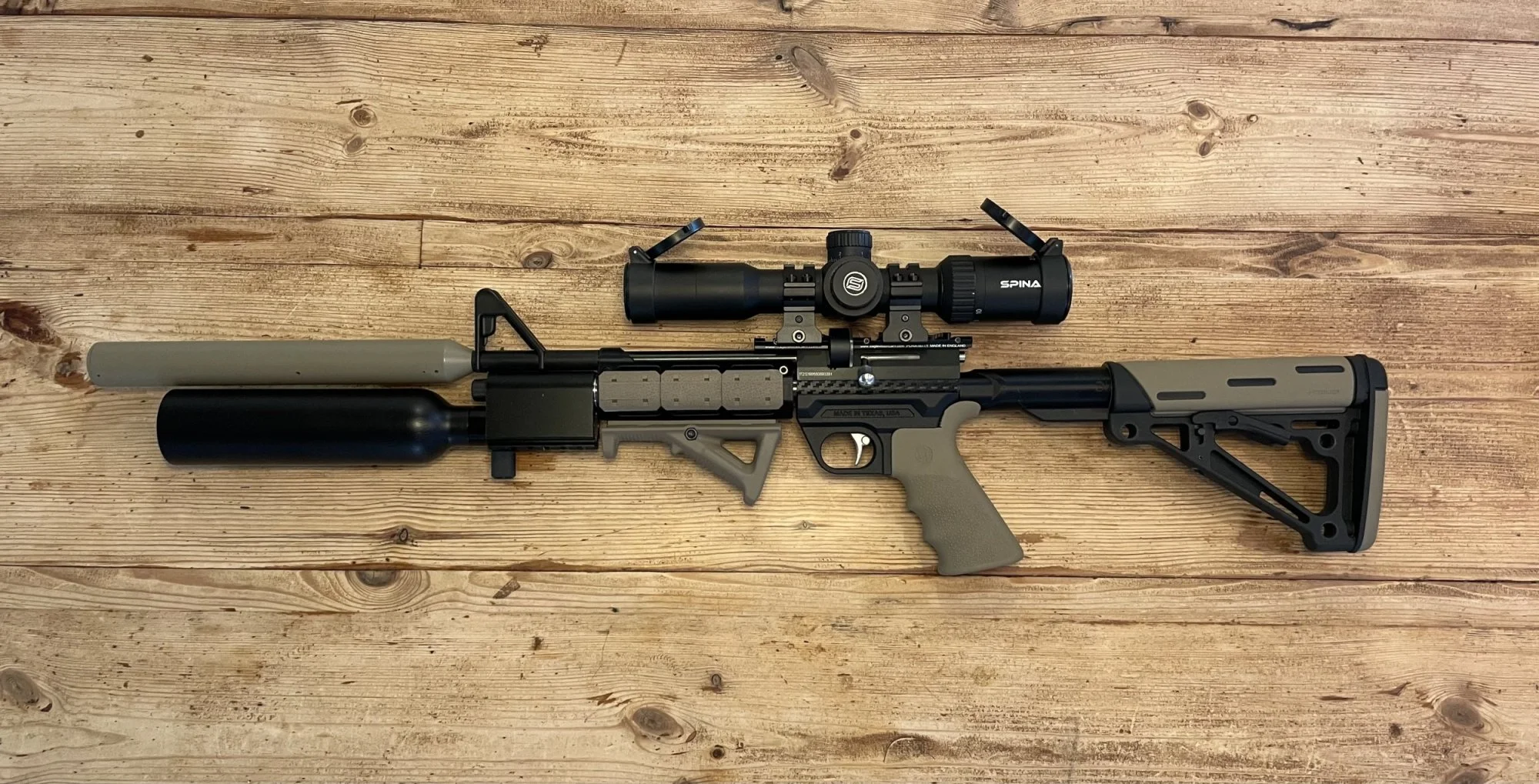

Are these from a Guy in Germany?
Look very good.
Was it a straight forward job to fit?
Yes Hitfire008. They needed a bit of sorting, the CP2 which they are “Designed” for required altering the rear tube stop. I made a new stop/guide so that the grip was fixed at two points. The wood grip needed filing back around the trigger guard. Everything can be done with a drill and a file (poorman’s lathe). I also drilled and tapped the carbine stock fixing block to give a more secure threaded fixing and made a rubber washer to cushion between the stock and the grip. See my thread CP1 Carbines. Bur basically, they are sound. If you aren’t a tinkerer, Bob Pattenden’s folding stock is tidy.

I understand, it is currently a “stand out” feature.
