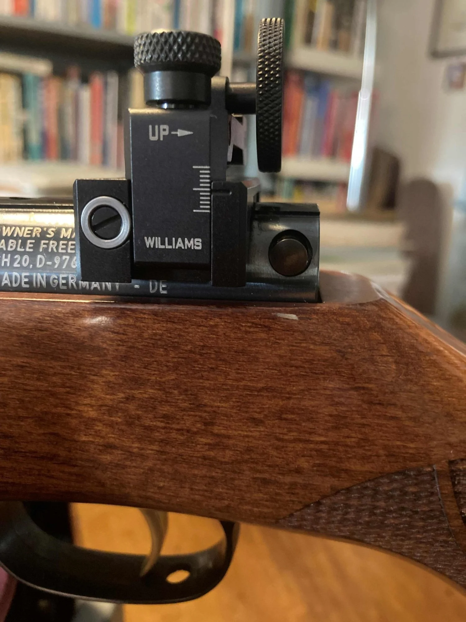

I notice you have fitted a sight to the rear of the 'scope rail & wonder if you find the longer sight base beneficial ?
nb. great looking rifle !
Thank you. In interest of accuracy, yes, a longer sight base / radius is always better than a shorter one. The receiver Williams sight also beneficial as it effectively removes a standard rear sight's focus/ setting sight margin for front blade from the equation; your eye automatically centers front sight in the Williams' rear aperture.The rear aperture also gives option to enhance front sight/ target view clarity/ brightness simply by either increasing ( brighter picture faster acquisition) aperture diameter or decreasing( focus/clarity) aperture diameter. Apertures are available from .050" - .140" or with a certain model from Centra brand, dial adjustable size , for target work.👍🙂

Many thanks for your response, do you mind me asking which sight you have & does it directly fit the 35's rail ?

They mention the williams sight is 3/8ths so 11mm, will the clamp up on a 13mm/ 1/2 inch dovetail on an old hw35 or will they not manage that.?

No worry, yes, they clamp right on. My sight is a Williams model FP- AG.

For those just starting to look into these aperture sights, a note to point out that 2 different sights are linked in the posts above: AG and GR versions of the Williams FP ("foolproof") series. The difference is how high (and low) they can be adjusted so depending on your specific rifle and/or typical shooting range, it might be important to chose the right one.
The FP-GR has a longer height arm which means it is more likely to foul the left stock when it is lowered for adjustment to shorter ranges. A relief cut into the stock to accommodate this should at least partially sort it out but is of course a permanent mod. (at least at my level of woodworking "unskill"...) Or, alternatively, a riser under the foresight...
The FP-AG's shorter height arm should not reach most stocks and I believe its smaller adjustment range should be sufficient for typical airgun ranges using the Weihrauch OEM front sight.
To give a rough idea, here is mine on my HW50s (UK 99), zero'ed at 10 meters.
With my sight base, I have at least 5 milradian upwards adjustment available to me which is more than enough for me and my rifles.
All that said, these are not sights I would want to be constantly adjusting as, even with the "Target Knobs" option, you still need 2 sizes of screwdriver to change elevation ("only" 1 for windage). They're brilliant for either known range paper punching or fit and forget PBR-based adjustment chosen to your rifle/pellet/garden/range/quarry combination.

If sat at a bench, paper punching, you use the knobs to " click", no different to using a scope. ( Williams' " click value" will be determined by the sight radius length on your rifle ) You merely leave the small locking screws backed out a bit to allow target knob use. Williams does make a thumbscrew to replace the main elevation lock screw, for the purpose of quickly releasing main elevation lock. The difference with a Williams is, unlike a Redfield or Lyman receiver sight , Williams sights have no zero lock/ return to zero screw.

You're welcome. Target knobs/ screws could be knocked up by anyone - they're a 6 - 40 TPI.
