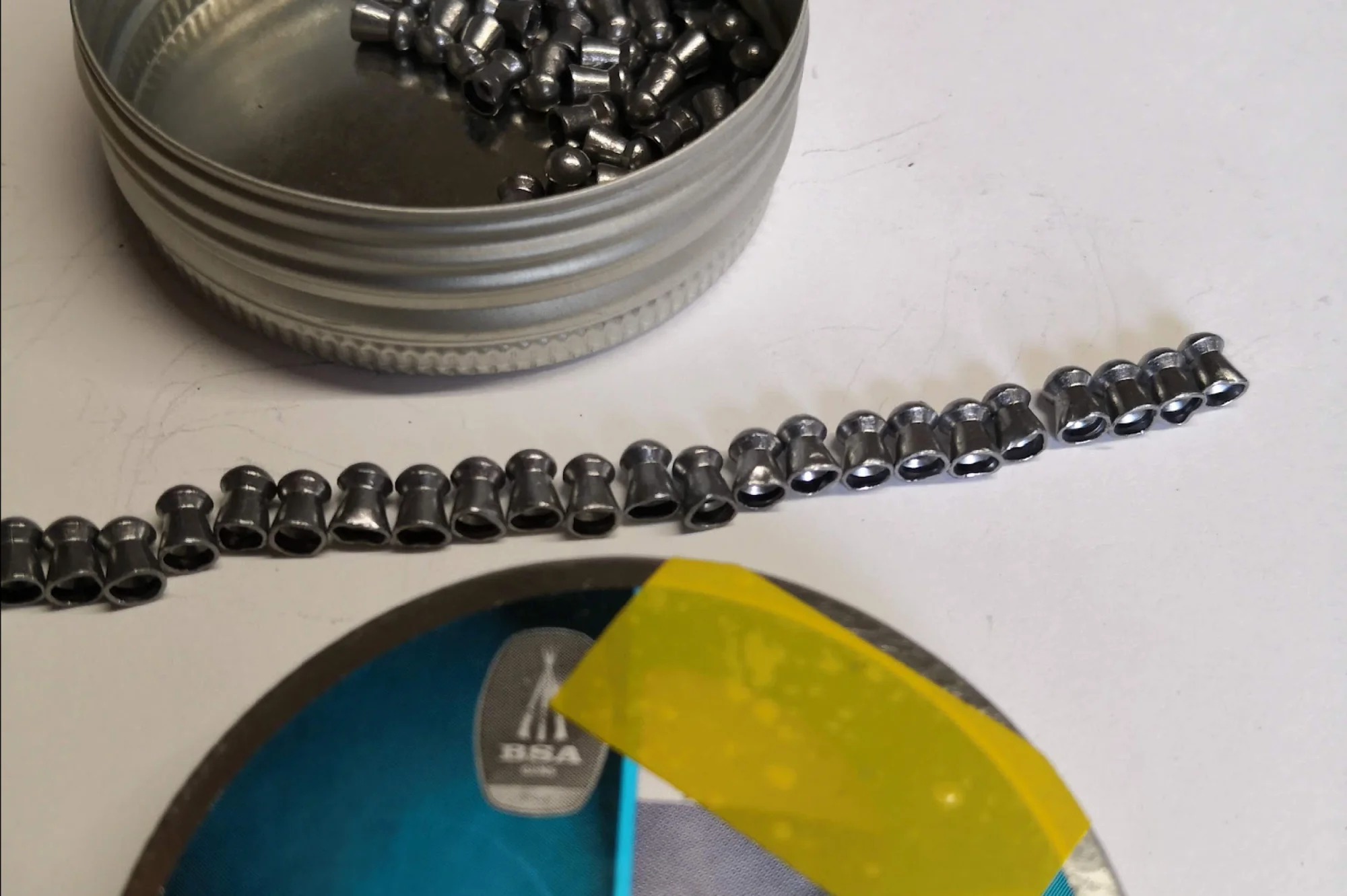

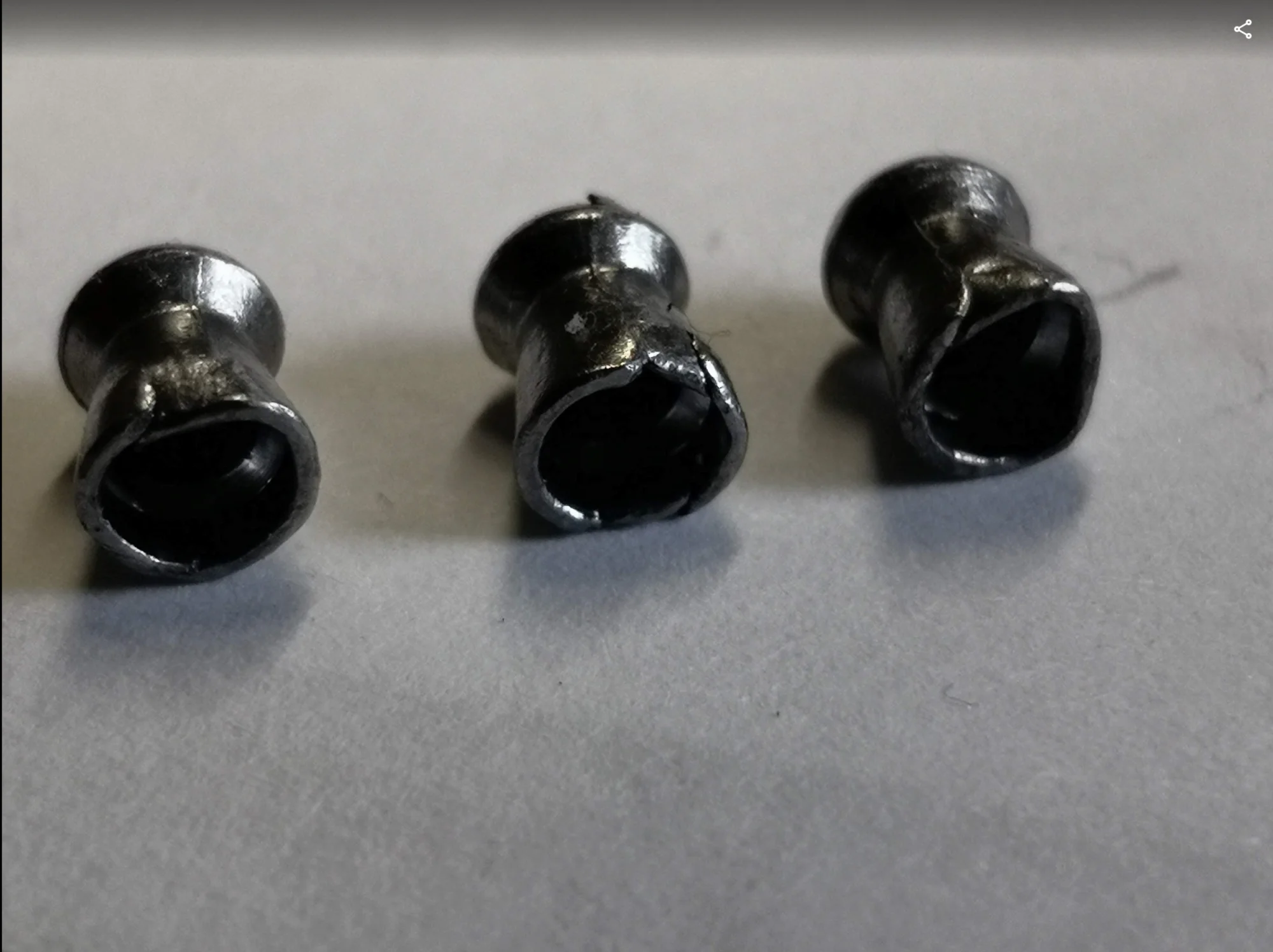

These were a few I've bothered to dig out of a tin of 250.
View attachment 915066View attachment 915067
My BSA are the same :) 2 boxes Max & Elite
@adredy. Thanks for posting that. I feel a little vindicated and that I was not alone.
As said, you are taking a chance where you can get batches of good or batches of bad. It feels like BSA pellets are packaged from whatever comes their way - which may be below H&N's own QC.
I got 3 batches of bad from 3 separate sources and I was stuck with them for a while as I often buy pellets in sleeves. At first, I gave them the benefit of the doubt as they came highly recommended and in so let down 3 out of 3 times. I'm not chancing a 4th time.
