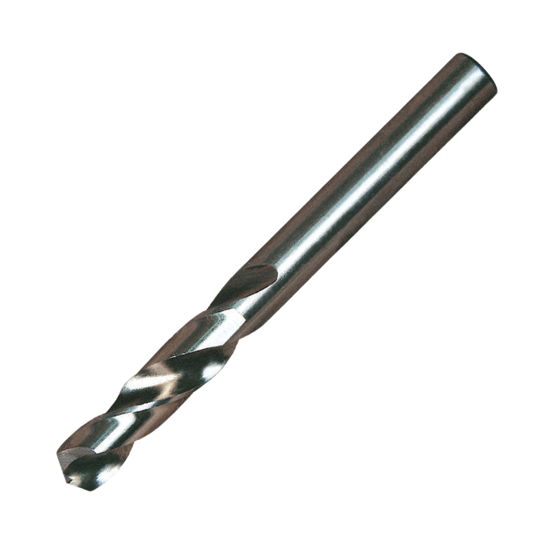

The OSG EX-GDS stub drills we use are self-centering and we would add a chamfer to the hole afterwards with a centre drill or chamfer tool of the desired angle.

Another for stub drills and (more) pilot holes(y)

If you are snapping a 8mm bit then it sounds like the bit is being bent during the drilling. If that's the case then don't buy cobalt drills as they are much more prone to snapping. Drilling in the lathe or a decent pillar drill, cobalt is fine, when the load is axial, drilling with a battery drill or similar, stick with HSS high speed steel. And buy a jobber length, the shorter ones, if you are not drilling a deep hole. My vote is for Presto, they make some good gear. Presto taps are excellent, and not silly prices either.
As mentioned, the problem with a hand drill no matter how slow you go, a slight movement from the square angle will cause a sharp drill bit to grip and break, possibly causing damage to your wrist depending on the torque setting and how quickly your trying to drill the hole.
Using a blunt drill bit is far safer, you can also save on a cutting lubricant by not using anything, another bonus is that the hole will never be in the wrong place.
