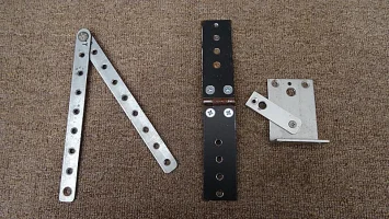

I've made a few in the past @Paulos , for both 6mm and 9mm blanks.
Just dug them out of my paraphernalia box...
I've got a couple of video's of them on my YouTube channel...
The hardest part is getting the spent slugs back out of the holder once they've splayed out at the back.
Sometimes you have to drill them back out :LOL: (y)

This is one sturdy target - two 4mm thick discs of 304 stainless steel. The steel fixing plate is of my own making...
Just PM me your address details and it's all yours. I'll get it posted out to you tomorrow.
I won't include the 6mm blanks themselves, because I'm not sure if I can post these via Royal Mail. If anyone else knows better then let me know and I'll include them.
Make sure you screw or bolt it to something substantial. (y)
