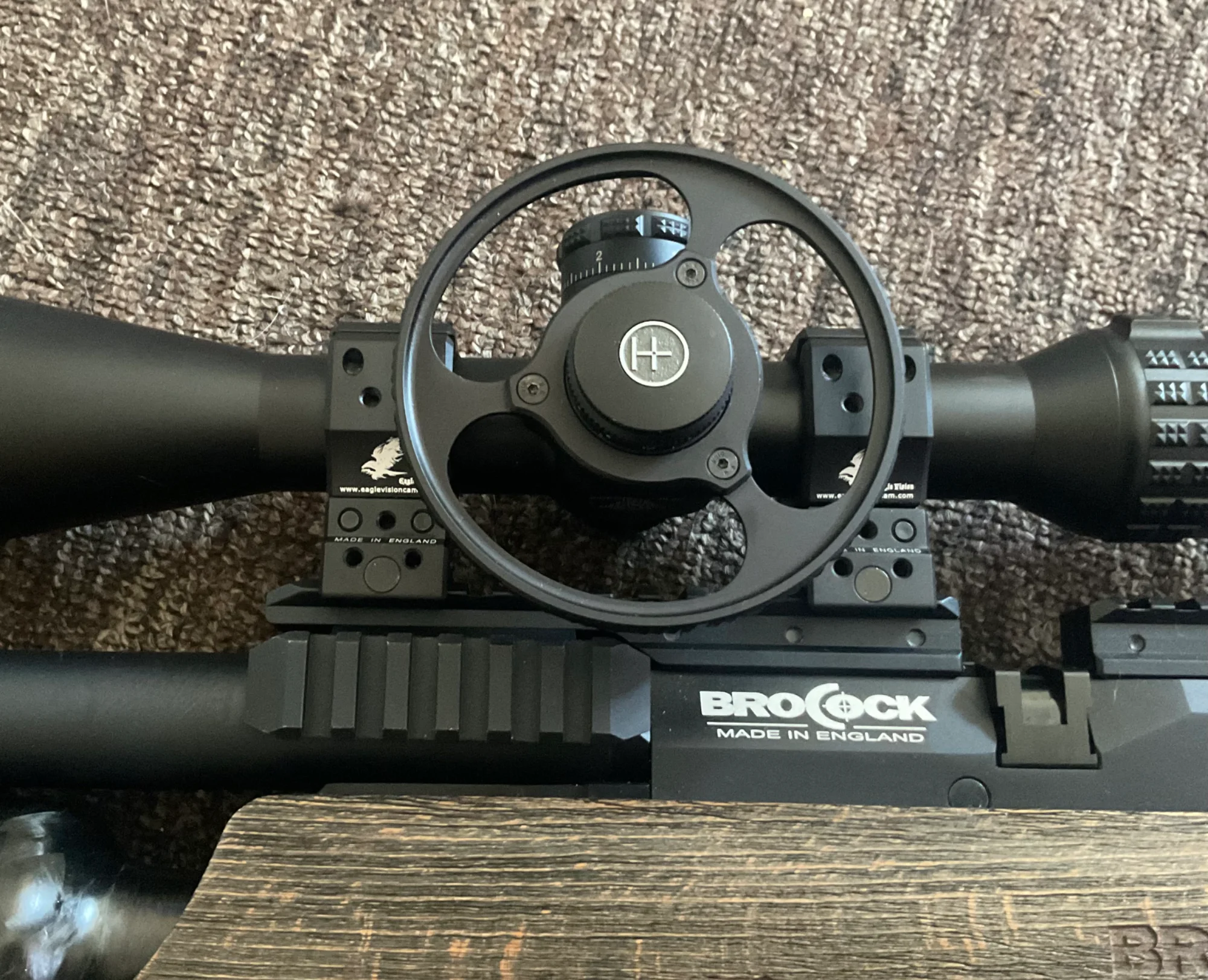

Just putting the finishing touches to the rifle I recently bought off the forum
Hawke Sidewinder SF30 8-32x56
Eagle Vision NMP-30 mounts
Hawke Carbon Fiber Pro Bipod
Rowan Engineering SSL
The rifle also have extended cheek riser posts, this was done by Nobby for the previous owner and the trigger has been upgraded to adjustable blade version again this was done before i got the rifle…

Had a couple hours at BARPC, one issue, I run out of elevation at 30yards, was about 1mil low, so need to investigate that now im at home, ill take some measurement’s and then try reversing the mounts..
Seems accurate enough with JSB Heavy’s, was throwing a few flyers with JSB 8.44, I’ll pick up a few other pellets to test out next week 👍
Problem is the 16 mil elevation adjustment on the scope, had similar with two Optisan EVX with 15 mil adj. range on two separate S510US.
Combine with the stack height over bore and you run out of adjustment
Cheers. Adjustable mounts it is then 👍
Everything else looks fine, the scope is parallel and the rifle is at 11.3fpe with heavy’s. Just annoying I only bought the mounts last week 😂

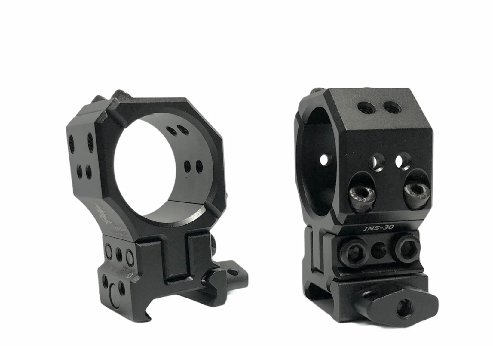

New scope mounts ordered, I nearly ordered these first time round ffs 😂
New mounts arrived
I’ve optically centred the scope and I’ll then raise the rear scope mounts to set a 25yard zero, I’ve got a set of feeler gauges I can use to help set the angle, I can do it in a somewhat controlled manner then 😂
Not really much to report today, was too windy to do any meaningful pellet testing, FTT, 8s and AADF seemed to group well enough when the wind dropped, I think the 8s were performing a tiny bit better, but hard to be 100% sure.. I’ll try again next week 👍
Got the scope zero’d though, i managed to get it pretty much optically centred for elevation at 25yard eventually 😂
Had a couple hours at the club this morning (link in my signature) and it wasn’t windy for once, she’s definitely liking Baracuda 8s, easy 5p groups from a full mag at 30yards with no effort, I’m no Target shooter so this is more than accurate enough for me 👍
