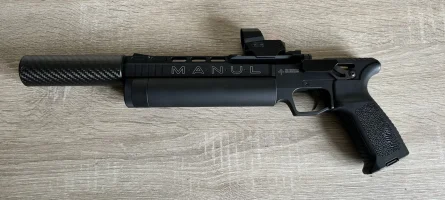

Picked this up this morning from Vector Air 👍

I’ve also bought a Form grip for it, it uses a standard AR beaver tail grip, I need a longer screw to mount it though, I’ve got nothing at home, but I know I’ve got something suitable in my lockup 👍
I'll be interested to hear how you get on with the Form grip. I was playing with the various grips I've got here and it looked to me that the supplied IMI grip is around the right angle to give a properly dropped wrist but the Form grip looks too upright.
Tbh I think I prefer the understated look of the IMI grip. Like you say the angle looks wrong, I’ll give it a go and report back 👍

Zero’d in at 10yards, was pellet on pellet rested and then stretched it out to 30yards and was hitting the 40mm bell pretty easily, even managed 4 in row, again it was rested though.
Took a couple reloads to suss out the mag system, the easiest way is to load the top 3 or 4 pellets and then fully rotate the mag to load the rest. The mag works on a ratchet, when you un cock the pistol it then trips the ratchet and it moves to the next position
I filled it to 240 bar and there was no discernible poi drop until it was under 50bar, it easily did 10 mags and may have even been more, I’ll do a proper count next time out with it
Pellet wise it liked the cheapo Excite Econ II straight away, so never bothered trying anything else

Been asked to post a couple pics of the open sights
Rear sight is a open notch 3.8mm, sits in a dovetail so can be moved for windage, not great, but maybe a decent 1911 competition style rear sight may fit, the dovetail is 9.5mm at its widest
The front is a 2.7mm blade, which is adjustable for elevation with set screws at the front and rear of the blade
