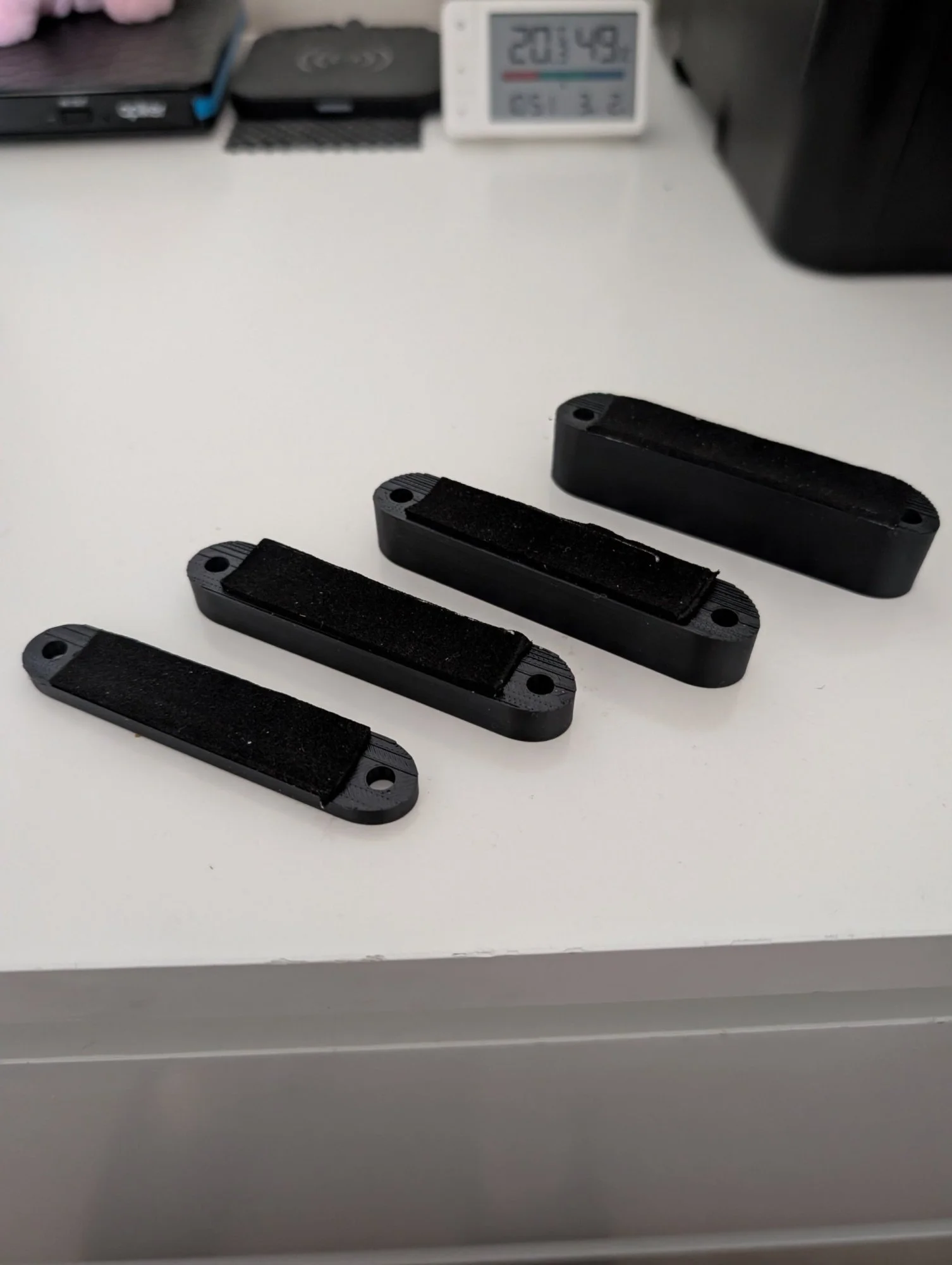

My lad was saying that the cheek piece on his AP900 was a little low so I came up with these 3D Printed riser blocks, they are in 5mm 10mm 15mm 20mm heights, they have a slight curve to one face to fit the stock and I have put a piece of neoprene on this surface to prevent any marking of the stock . The only thing he had to source were some longer M4 countersunk screws. It is possible to stack these for a higher cheek piece if you want to. I have the file if anyone wants it I'm not sure if I'm allowed to post it here.
