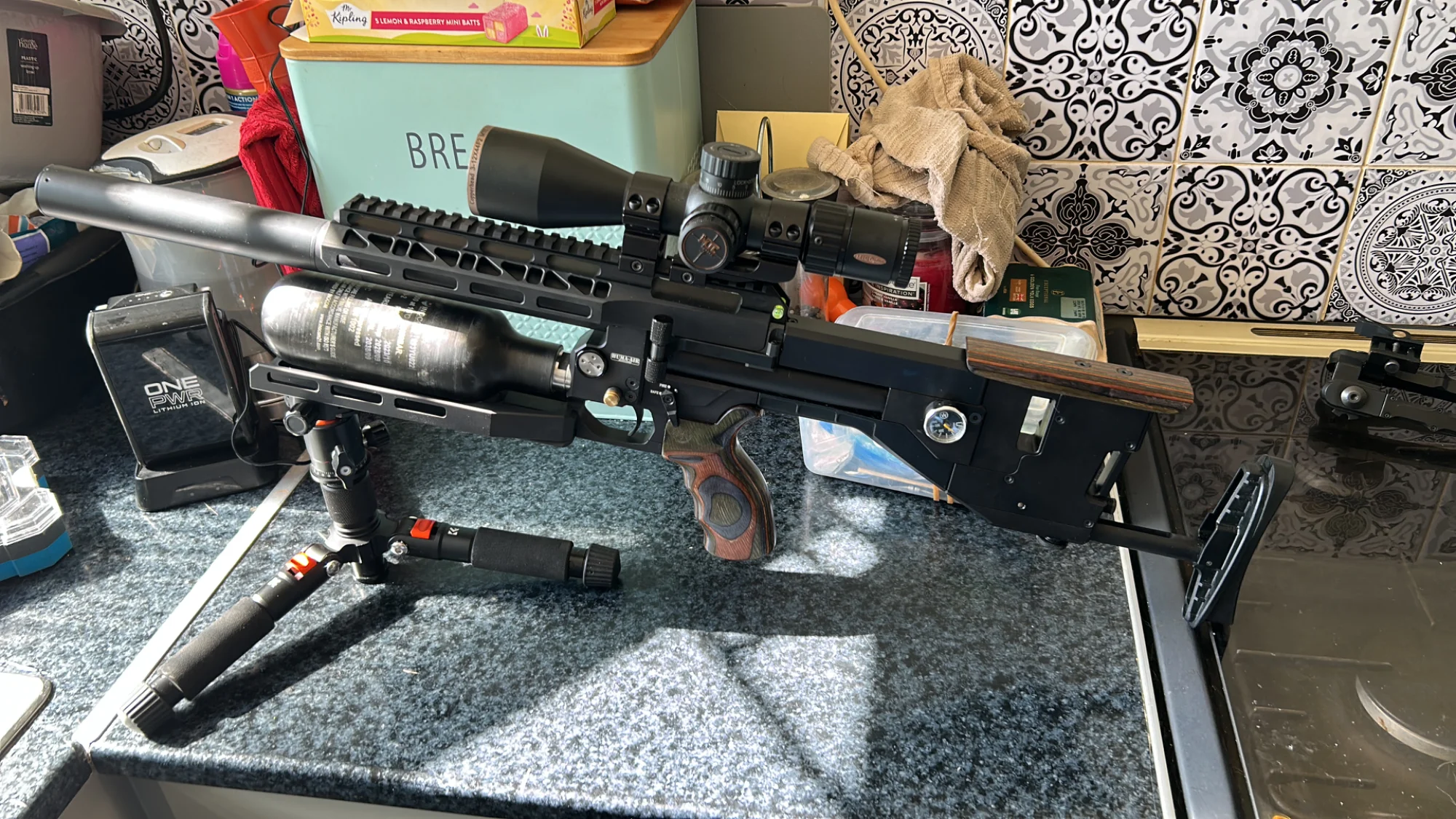

Finally had five minutes to put the lam stock on it, plus it feels like it handles better to me …well pleased. Sure you’ll be seeing plenty of hunting posts before long of me slaying 🤣👌

Then I got thinking, how about having a moderator that screws directly into the part that centres the barrel. So off I went and contacted Voldemort, a few photos and questions later it was decided that the best option would be to send the entire baffle set to him for precision purposes.
A short time later this baby arrived, after some decibel checks it’s coming out 5db less than the original baffles with a weirauch xlk moderator fitted and no change in poi so I’m more than happy with the results.

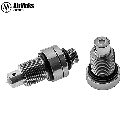

Krait Standard, now after shooting couple tins of pellets I am very pleased, overall everything and especially accuracy.
Only issue fo far has been with quick bottle change adapter I got later. It has popped few O-rings from between bottle and block piece, two were a bot sheared and one that was softer one, that was just blown away without touching anywhere at that time. So it has cleared up for me that NBR90 is probably the best hardness, the size, 4 x 1.0 or 4 x 1.5, which it should be?
Now installed is 4 x 1.5mm NBR90 ( I think) and it is holding fine, what happens when exchanging the bottle, that is yet to be seen... Anyone using same adapter, does it work ok for you?
Maximum allowed pressure for both is 300bar, better to use lower (250bar?) with adapter or should it work ok with full 300bar fill? Havent dared to try, new set of Viton FKM O-rings is coming my way but still in hands of postal service. But they are 4 x 1.0mm only size I could find nearby.
Is that a genuine one? Mine looked much better machined than that.
Yes it should, it is this one. I must admit that it looks cleaner in webpage pictures... but have no reason to believe it wouldnt be Airmaks product. Also I think it was in correct packaging with stickers you would expect to find
