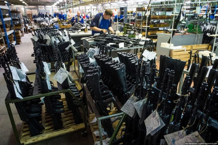

Who fancies a tour of the IZHMASH plant?😄
A tour of the Izhmash plant, the birthplace of the Kalashnikov assault rifle thanks to “Nevsedoma.com”
If you're interested in how Kalashnikov assault rifles are manufactured, we suggest you take a tour of the Izhmash plant, the birthplace of this legendary weapon. A photo report with detailed commentary awaits you below.
There's nothing unusual about weapons production. First, individual components are made, then everything is assembled into a rifle or, say, an aircraft cannon. This is how molds for casting certain parts are made. These models are made from a modeling compound (paraffin, stearin, and something else). Then the models are assembled into blocks.
A slurry is applied to the block, sprinkled with sand, and dried, resulting in a ceramic mold. Then a model is cast from this mold and steel is poured in.
The finished parts then need to be cleaned by hand. Everything is lovely, homey.
Parts are heated in ovens to a specific temperature, which changes the structure of the material and its hardness.
And this is a salt heat treatment bath. The parts are dipped in hot salt.
An etching line. When the weapon parts undergo heat treatment, they become glowing. This heat is removed using chemicals. The etching line is already new.
The old workshops look like this.
Look how warm everything was at the plant. Flowers, posters, tea and candy.😄

Let's move on to assembly! Pressing the receiver and barrel together which factory workers call “the wedding."😄
There are several production streams: mass production—military products and civilian weapons based on the Kalashnikov assault rifle—sniper rifles and the Tiger shotgun based on the sniper rifle. Incidentally, weapons named after animals are referred to by factory employees as "our zoo."🦍😄
The streams are organized differently: in the first case, it's a conveyor belt, while in the second, it's a multi-batch assembly line, meaning each item is assembled by a single person.
During production, an assault rifle or other weapon undergoes a number of checkpoints: three at launch, seven at release, and then after each operation. For military products, for example, the interchangeability of parts is checked.
One section produces sporting and hunting weapons (the Los and Bars carbines, etc.) and the SV-98 sniper rifle.
Despite equipment modernization, the assembly principle will remain the same, with a significant amount of manual labor.
After the "wedding," the product is sent to the coating process, and from there to final assembly. The barrel and receiver are joined with the cover, buttstock, forend, grip, and other components
