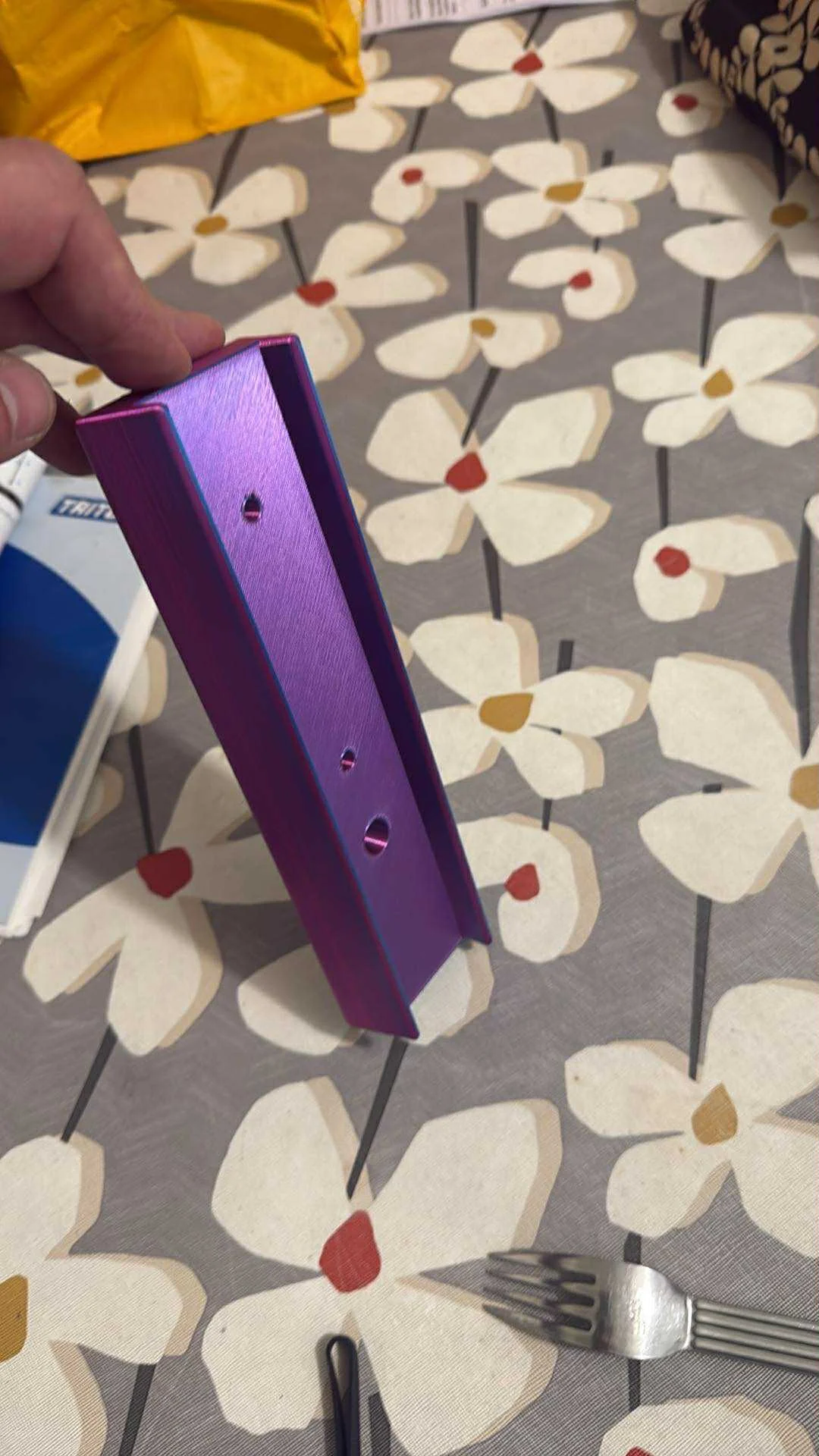

Hamster printed with recesses for lead weight and a steyr tube clamp and end cap removal tool.
